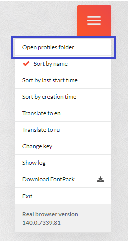

I don’t want to save just 1 profile — I want to save every profile in that way.
For example, if out of 50 tries I successfully create 5 accounts,
I want those 5 profiles saved, each in a separate folder like Profile 1, Profile 2, … up to Profile 5.
Then, I want to load these 5 profiles into Fingerprint Manager 3.0. -
Create a resource "Files from folder", for example the resource "Profiles_global_path" — this is where you specify the common folder where all profiles will be saved.
In recording mode, call the action "Resource location", insert
{{Profiles_global_path}}, and you will get a variable likeRESOURSE_LOCAL_PATH(or something similar — it will be the default variable). -
Now you need to get the login of your account (for example, an email). You should parse it using the action "Parse CSV" — your goal is to obtain the variable
[[USERNAME]]. -
Create a variable
PROFILE_PATHusing the action "Set variable", and inside specify two variables so that it will later be easier to handle logs and not carry around two variables across the script:[[RESOURSE_LOCAL_PATH]]/[[USERNAME]] -
Create the action "Browser settings", scroll all the way down, find the section "PROFILES", and in the very first field insert
[[PROFILE_PATH]]. -
Once you’ve created the profile, run your registration logic and add a check for failed registration. then call the action "Delete file/folder" and pass
[[PROFILE_PATH]].
That’s all. Just repeat exactly what is written.
